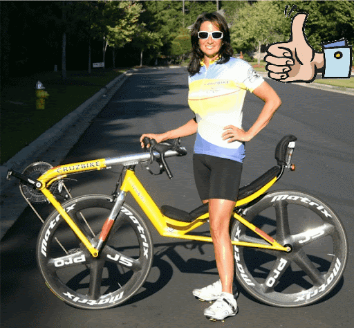

There is a ton of pedal steer in the Cruzbike, admittedly. I think that one big difference between the Zockra KA geometry and the Vendetta geometry is that the Vendetta is set up like a rowing machine.
In a rowing machine, you pull the weight towards you, in a straight line perpendicular with your chest
On a Vendetta, you do the same. That's why the boom is straight, and incredibly beefy. By setting it up like a rowing machine, we have two forces acting on the pedals. First, your legs are pushing against the pedals. But at the same time, your upper body is 'pulling' the pedals in harmony.
It's a bit hard to describe. It took me a few weeks before I could get a good rhythm going, but once I did, it felt very similar to riding a DF bike out of the saddle, except my whole body is rotated ninety degrees.
If you look at Parker's pics, it seems like her shoulders are getting broader over the past couple years. Which would be consistent with an upper body workout due to the bike.
